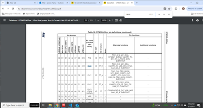

Thanks, we are updating the code as per your suggestions and about to try. One other information is that USBCRS_SYNC (PA10 AF10 function) Is routed in the board to connector. But the USB cable do not have any pins for this? And datasheet doesnt explain what USBCRS_SYNC pin do? can anyone explain about this pin

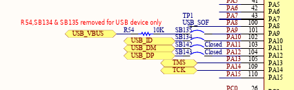

Just from circuit nucleo-L4xx :
PA10 -> USB_ID , but not needed for device only.
Iam confused, as per data sheet PA10 is  USB_CRS_SYNC,

Does this mean this pin is needed for working with Android Tablet? wondering why it has no issue with windows/Mac

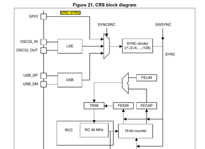

Me too :)

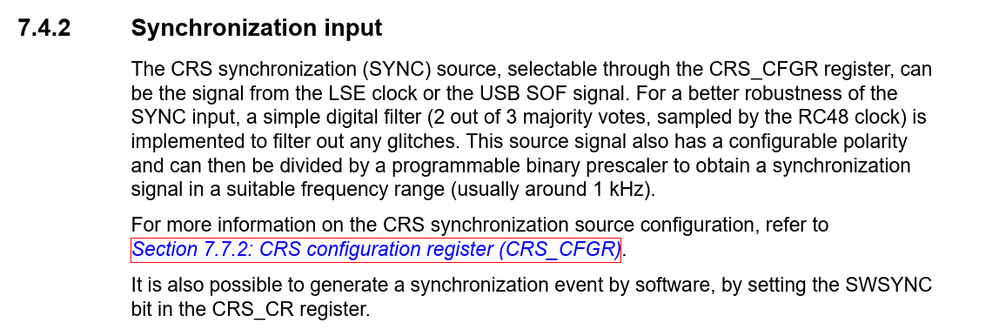

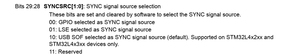

crs_sync seem needed for crystal less -> sync the HSI48
IF you select it as sync source :
from rm:
No, nothing about "Samsung" here. :)
IF you select it as sync source (see my last post) you need it as sync input . (If you use crystal less.)

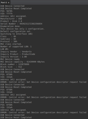

Might be some help, to see the debug messages from USB lib : do you have SWO usable ?
If debug enabled in HAL/usb lib, as host i get from swo :

Mass storage class showing same issue, detecting on Windows, but not detecting on Android.
The external clock (HSE) using now.

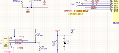

Below showing the schematic in which USB_DM and USB_SYNC is interchanged. Is there any possibility to work the USB in windows, if this pins are interchanged?
No - hey, but everything is possible in certain reality. :)
If really mixed up - correct it. And try connection then...
