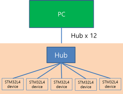

2025-03-13 10:01 PM
As shown in the figure above, I made a device using the STM32L4 CPU.
I connected these devices to a hub commonly sold on PC and laptop, and connected about 60 STM32L4 devices.
An exclamation mark appears in the device manager and it is no longer recognized as a Com port.
I want to know why the number of Com ports connected in the device manager is different for each PC.
2025-03-13 10:02 PM
Thank you for your answer.
