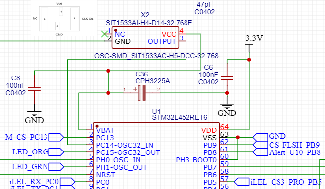

I have an STM32L452 rigged to use an external clock so we can keep the RTC running. Schematic attached.
X2 is a clock from SiTime, programmed to be 32.768kHz. C36 is a supercap acting as battery backup. I used STMCube to generate the startup code to feed into HAL_RCC_OscConfig. When I debug into this function, the LSE never becomes ready (RCC_BDCR_LSERDY bit always zero), and so the code returns HAL_TIMEOUT.
Do I have the correct circuit? Have I set the clock config correctly? It's the same if I run on a Nucleo board.

2023-11-16 12:16 AM
Turns out that the wrong clock chip had been fitted - they'd used the low-power variant, so the swing on the clock signal was not sufficient for the processor to detect.

2023-11-08 9:07 AM
where is the vbat power coming from ?? CPHxx is a big cap - and empty. needs some diode or so from vdd -> cap, to charge it. otherwise the 32khz osc never gets power.

2023-11-08 9:32 AM
My colleagure assures me he can see the 32768Hz clock on a scope. I use VBAT output to pwoer the supercap thus:

2023-11-08 9:51 AM
ok, so cap is charged by cpu internal 1k5.
so maybe you have to wait more time, until 32k osc signal "ok" .
or/and reset restart rtc , when signal "ok".
