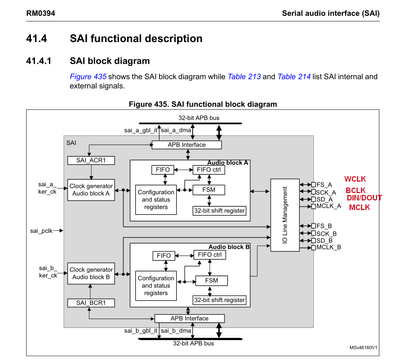

MCLK -- Master Clock
WCLK = FS = LRCK -- Word Clock = Frame Select = Left-Right Clock
BCLK = SCK -- Bit Clock = Serial Clock
DIN/DOUT = SD -- Data In/Out = Serial Data

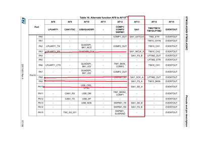

Then, in the datasheet, you'll find to which pins are these signals connected, for the selected SAI's A or B portion (example is from a different STM32 than yours):
