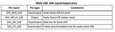

I advise you to refer to reference manual "Table 235. SAI input/output pins" for pin descriptions.

Just set the SAI in Cube and the mode you want.
You see the pins and pin functions then.
