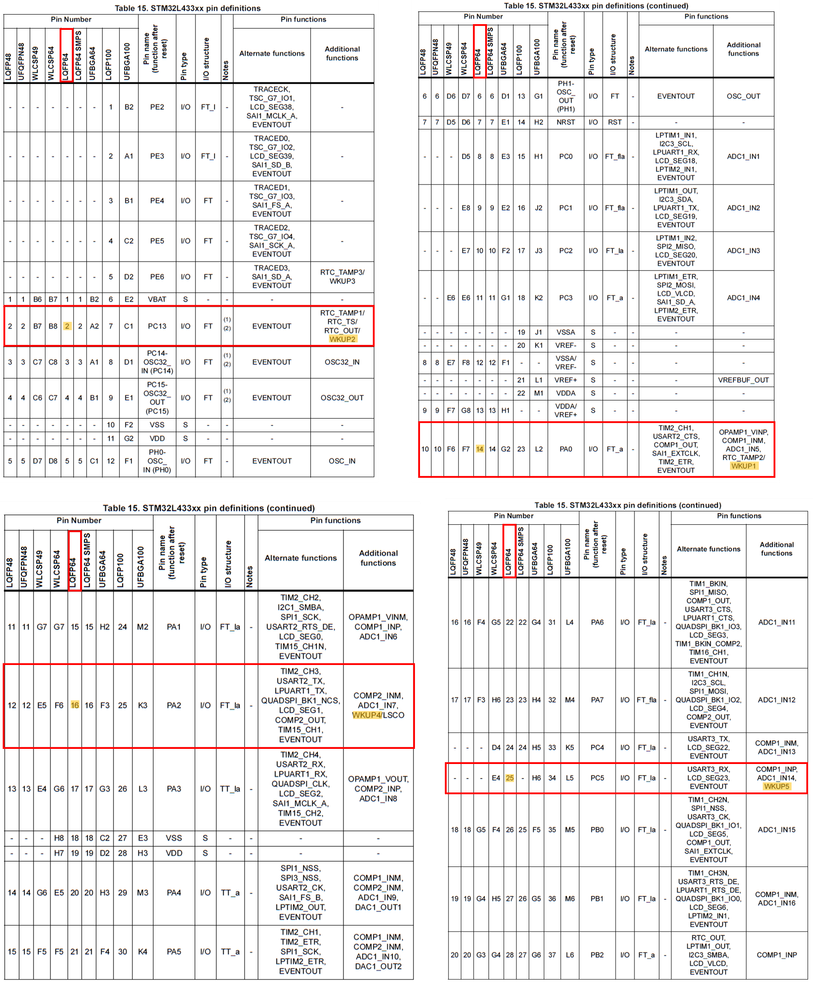

@freeflyer wrote:Using a WKUP pin becuase it allows for lower sleep currents is the sort of advice I am lookng for
You can see that from the tables: the "deeper" sleep modes have only WKUP (not GPIO) as possible wakeup sources.

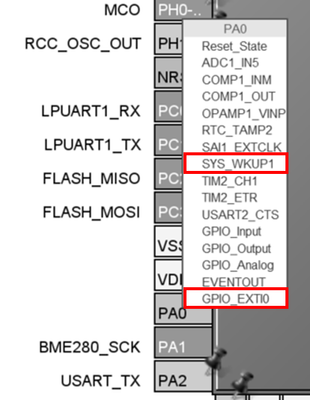

So on the LQFP64...
(WKUP3 is not available on LQFP64)
In STM32CubeIDE, do I set one of the above pins to GPIO_EXTIx or SYS_WKUPx ?
2025-07-08 8:57 AM
@freeflyer wrote:In STM32CubeIDE, do I set one of the above pins to GPIO_EXTIx or SYS_WKUPx ?
You want to use it as WKUP - not EXTI - so set it to SYS_WKUPx
