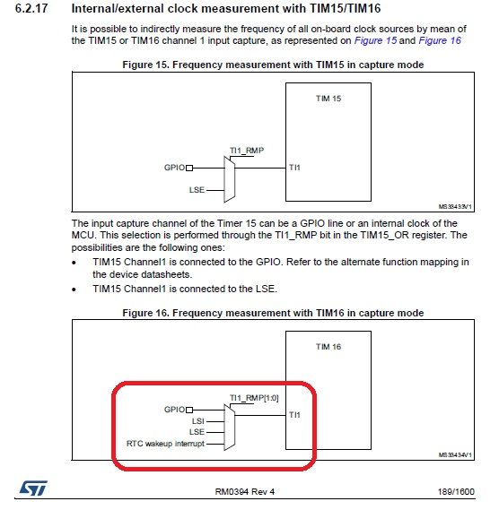

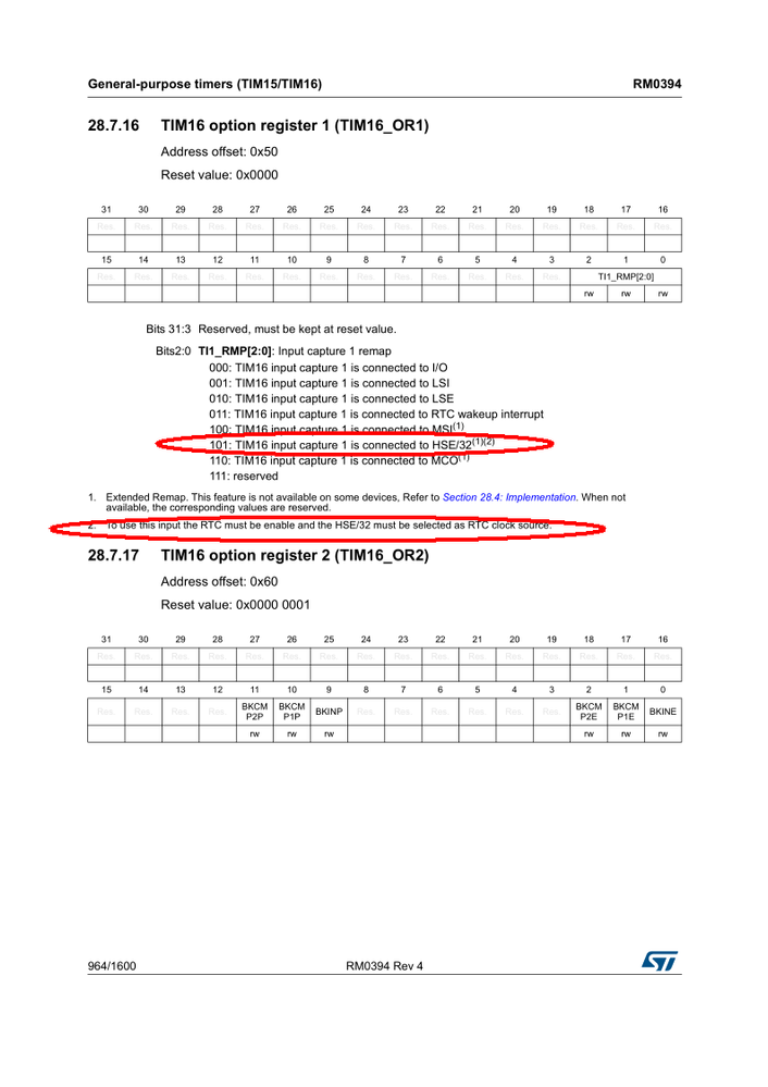

> I didn't see the HSE/32 option for TIM16, I'll look at it again. Perhaps via RTC clocking from HSE divided down.
If the footnote is true, it's not very useful if you intend to use RTC too.
In the "Big Orca" 'L4 RM0351 rev.5 there is no such note (the HSE/32 is said to be connected to TIM17 there).

More crappy documentation, the section describing this functionality for the upper bit patterns is missing. The bits are described in the STM32L432xx.h file and the related TIM HAL/LL files via a #ifdef
On other plaforms this is called RTCCLK, because it is only technically HSE/32 under specific conditions. Arrgghh!!
2018-10-25 2:02 PM
> On other plaforms
What do you mean by other platforms here?
Do you think the 0b101 setting in TIM16_OR1 does not connect specifically to HSE/32, but to the output RTC-clock mux controlled by RCC_BDCR.RTCSEL? That's what is called RTCCLK in 6.2.13 RTC clock and also in the RTC chapter.
