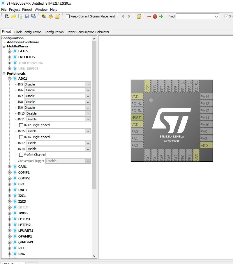

did you check the cube ?
checking now, set PA0 to Analog..
ooops there is no AD0 on this processor, according to the cube...
