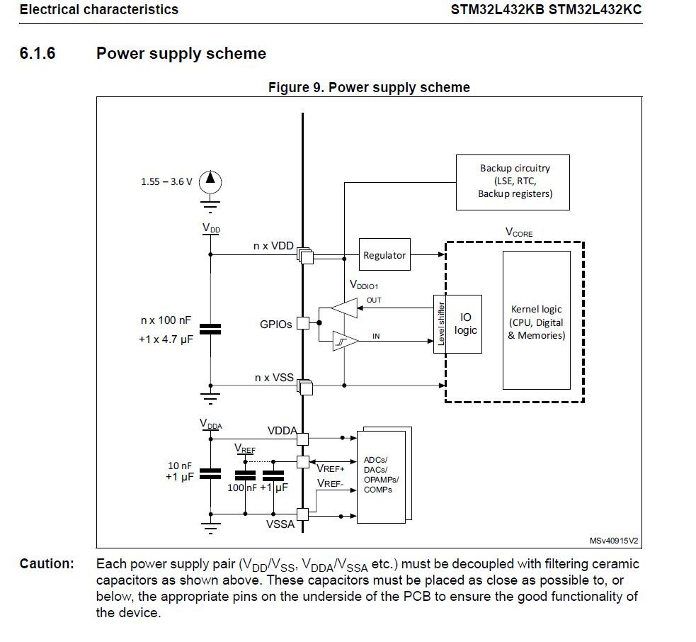

Here definition from the datasheet, but in the 32pin package there is no VDDA !
Is any VSS also the VSSA ?

I assume that only one of the VSS pins is connected to VSSA/VREF-. The DS ought to say so. @Imen DAHMEN , can this please be clarified in the DS?
