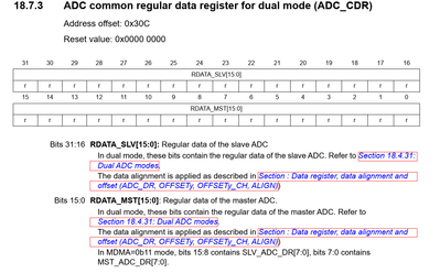

ADC_CDR is 32 bits and has two parts...

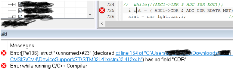

This is how i tried but, i don't know why it's happening. I have not even seen CDR register is there in registers list. Please acknowledge and respond. Your help will be greatly appreciated.

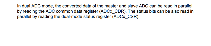

Please have a look into this. I'm trying to enable both regular and injected in ADC_CCR register so, we have to read from ADC_CDR regiser. Your help will be greatly appreciated.

The common ADC register is at ADC12_COMMON->CDR, not ADC1->CDR.
