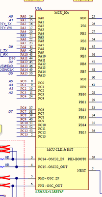

Am working on STM32L412RBT6.
We made a custom PCB for our product and Am trying to PD2 as digital output as toggle function.
I can't able to find any high output at PD2. The pin PD2 is always remains low.

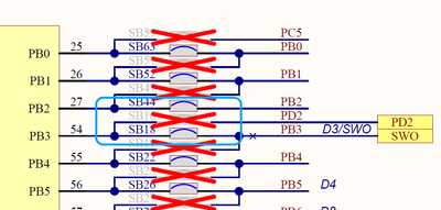

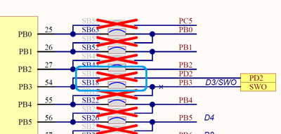

No its a LQFP64 package. Please check the snap which i took from the NUCLEO-412RB schematic

2024-06-13 8:47 AM
But pin 54 is PB3 , not PD2 . Right ?
Which LED is there ?
2024-06-13 9:02 AM
Attached a simple project toggling PD2.
But also need to check the solder bridges SB16 and SB18:
SB16: needs to be soldered and SB18 needs to be disconnected.

Sorry i forgot. Yes we are facing the same behavior in NUCLEO-L412RB board. As you can see that in schematic, PD2 is not going anywhere and it is coming directly to the connector. I have probed at the connector as well as in controller pin (54th).
2024-06-13 9:09 AM - edited 2024-06-13 9:09 AM

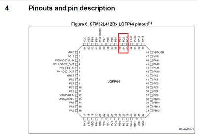

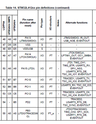

According to the datasheet pin 54 is PD2:
But in CubeMx if you create a project based on the NUCLEO-L412 board you get pin 54 is PB3! It's based on the default solder bridge SB18 soldered/SB16 disconnected:
