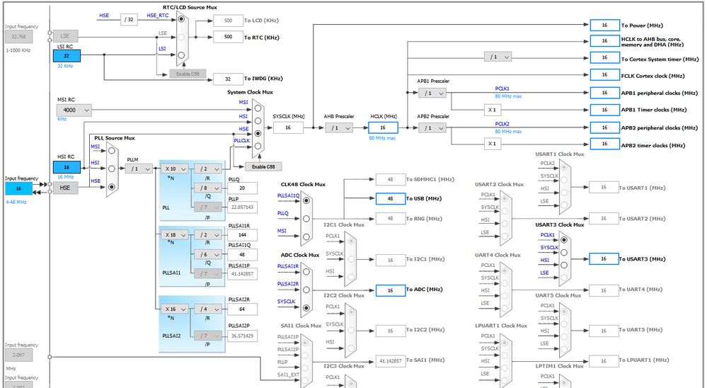

Here is my setting with a SysClock of 16 MHz that work for USB if that might help:
2018-09-13 7:14 AM
Sorry, seem like the image did not follow
