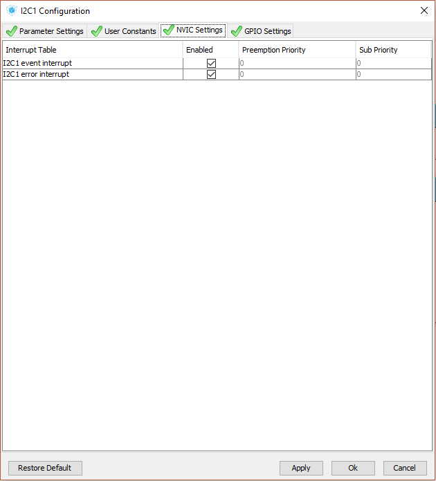

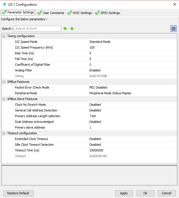

I changed a couple of things in the configurations (screenshots below) and changed the code to the following:

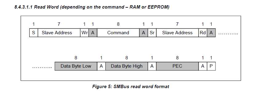

My sensor is now working! Here's the code:
char buffer[5];
float temperature;
int main(void){
while (1)
HAL_I2C_Mem_Read(&hi2c1, 0x5A<<1, 0x07, 1, buffer, 2, 100);
 int_temp = (buffer[1] <<8 | buffer[0]);
  temperature = int_temp*0.02 - 273.15;
  HAL_Delay(200);
Since the sensor needs a repeated start, HAL_I2C_MEM_Read() will do the job for you! Because of the stop-condition, which is set by HAL_I2C_Master_Transmit and HAL_I2C_Master_Receive you wouldn't be able to read the values properly because of that missing repeated start. Mem_Read on the other hand does the following: start, I2C address + Write, Memory address, repeated start, I2C address + Read, N bytes, stop. Besides that when combining the two data bytes you have to pay attention that the lsbyte (in my example buffer[0]) comes first, so you have to shift the msbyte by 8 and "OR" it with lsbyte. After that you'll get proper temperature-values.
Hope this will help other people, struggling with this sensor.
