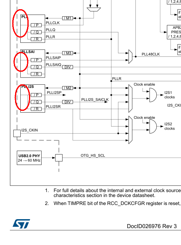

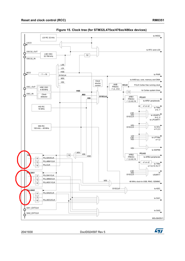

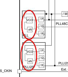

Hi Bruno,
the block schematics in the RMs are perfectly understandable, except that those in the L4 RM miss the PLL ''multiplication'' element itself.
That was what turbo was talking about initially (and I misunderstood his question).
Please, re-instate the ''xN'' (even if the multiplication sign is factully incorrect there), as is in other families' RM (e.g. in RM0090):

It's missing in RM0390 ('F446) too
ST, please, correct these RMs.
2017-09-07 2:13 AM
You are right!
Thank you for bringing this issue to our attention.It is noted and will be fixed in coming release of the documents
