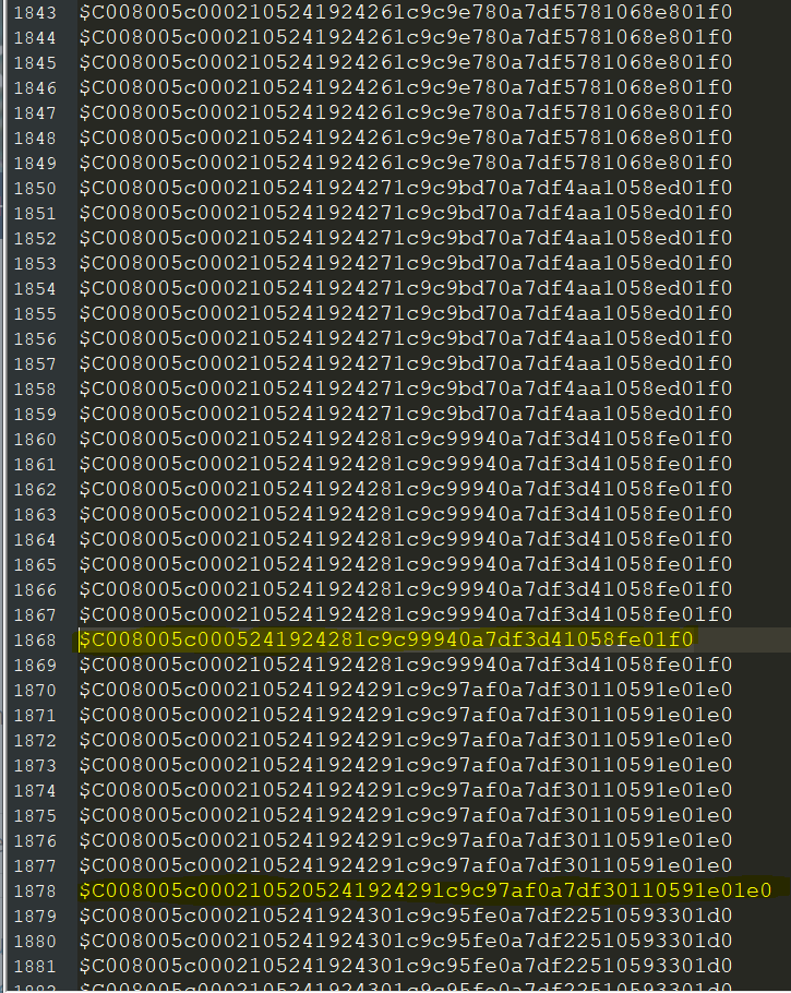

I have custom HW on HW I`m using MCU STM32L496RTx and SD card. SD card is connected with SDIO to MCU and in FW I`m using HAL libraries - DMA+SDIO+FATFS.
My aim is to periodically save datasets to SD card. I generate string with 51 characters. I don`t want to save each string alone but in one package.
When I`m trying to write 13056 bytes (256 * 51char) it is working properly. But when I`m trying to write a smaller amount of bytes (example 50 * 51char) writing is not correct. It seems to be ok but some chars are duplicated or missing. This wrong sequences seem to be periodical.
I tried it with not generated data, only with static string to find out if the problem is with the data generation but the problem remains. So problem is probably with writing to SD card.
