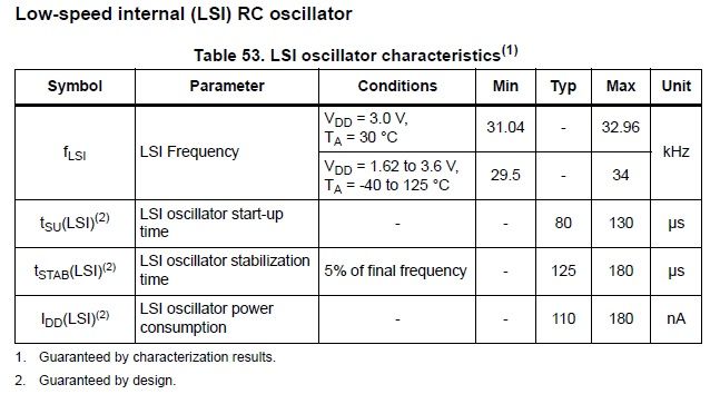

I am using STM32L4S9 and the datasheet mentions the LSI is 32khz. Is this 32000hz or 32768hz?

The datasheet is correct. LSI is 32 KHz.

Seems like nominally, the frequency is 32000Hz. I think this is solved then.
