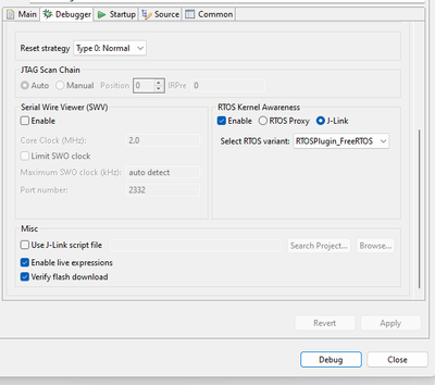

Issue solved.
The problem was caused by the RTOS kernel Awareness - RTOS Proxy being enabled, to see the thread properties during debugging. However, when switching from RTOS Proxy to J-Link, the performance issues were resolved immediately. But, of course, this requires J-Link.
