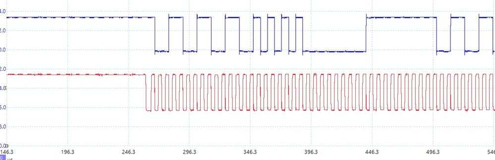

Here is the logic analyzer trace of what happens on the SPI data out line, and the clock
It was captured using the code above. You can clearly see that the first 0x33 comes out doubled, followed by 0x55, 0x0 and 0xff.
Since I do not stop the clock after that (being the test code), the SPI continues outputting 0x33, I guess it is the SPI behavior when in underflow condition.
What is important is that the SPI peripheral is deInit and re-init every time when I call this code. IMHO it points to a racing condition in the SPI IP becase different clock rates behave differently with the same code.
What do you think?
Yes, I've been explicitly assured here by ST that this is the case, can't find the thread at the moment.
> No, the idle state doesn't depend on the clock.
But obviously it's not 0 while you set CPOL to 0.
Note this line in RM:
The SCK signal must be settled at an idle state level corresponding to the selected polarity before the SPI slave is enabled.''

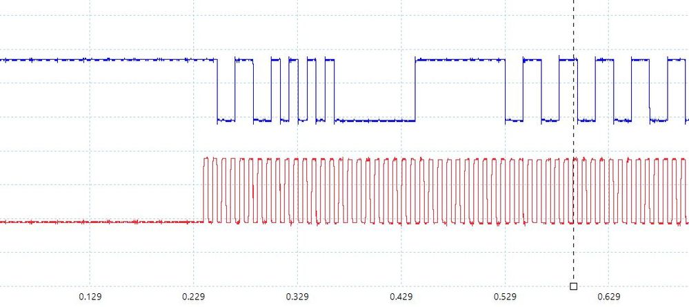

Well, it appears I was wrong, because I made an assumption (wrongly) that the idle state of the clock doesn't depend on the rate. It does.
Below is the correct behavior of SPI at a different rate.
Looks like the transceiver is acting differently at different rates, and the SPI responds differently.
