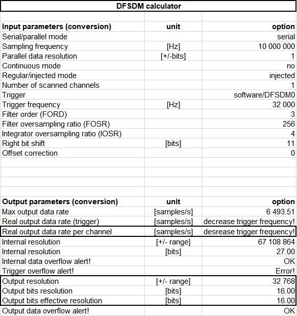

Any ideas why values would be non linear in the approximately the upper 1 to 2 bits?
For the setup below, it is linear to between -17000 to +14000. Doubling the + output only yields around +18000. These are raw values. This really acts like an overflow somewhere it seems to me. Test input is DC, in this case using an AMC3336 TI modulator.
What am I missing here?
