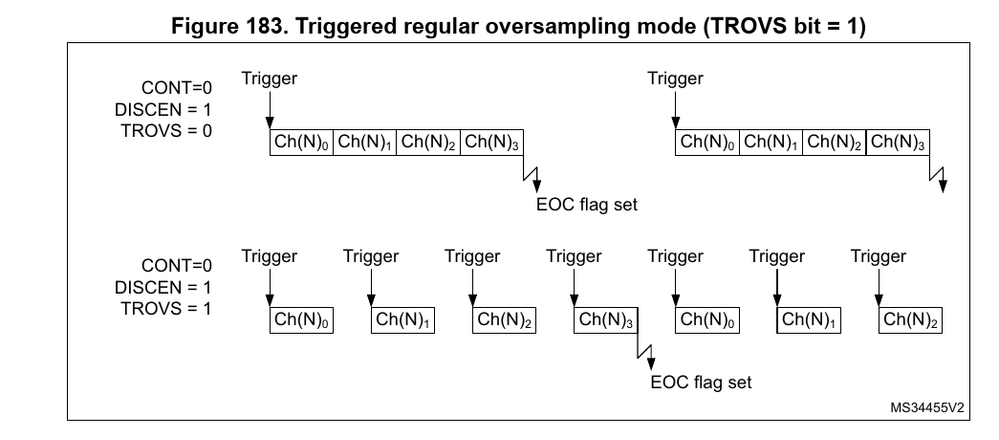

look in rm , chapter ADC : here from H743 ->

2023-03-13 2:58 AM
yes. basic timing stay same. only data is average of 2 or more sampels, with better resolution (should have...).
(as i understand it...) exept you use a mode to trigger every conversion:
but if you make sampling time very long - yes, then you could control sampel rate this way.
just - more "usual" way would be : set sampling rate by a timer, triggers ADC. then with short adc-sampling-time you get always same clear defined sample frequency, just more resolution with oversampling. (observe time needed for all the sampels when ov .)
