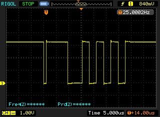

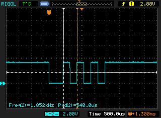

Good afternoon, I am trying to init UART5 on STM32L152 and it is work wrong.
In the end of thesw_uart5_init
function0xAA (0b10101010) value issent to the UART5 data register. The transmission result, registred with osciloscope not same as value sent to the data register. Can you find a mistake in the code or give me some workaround how to solve this problem?
I'm really appreciate your help. PS. The same deal with DMA, corrupted data.void

2014-07-28 6:27 AM
Doesn't look unreasonable, there is a START bit, and the data is sent LSB first.
You are measuring two bit times. If that's wrong review how you are clocking the device, the external crystal, and HSE_VALUE definition. You should wait on TXEwhile
(USART_GetFlagStatus(UART5, USART_FLAG_TXE) == RESET);

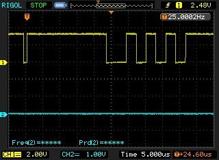

2014-07-29 3:33 AM
2014-07-29 5:10 AM
Just move the I/O pin initialization lines after the UART initialization.
While the UART is in reset it keeps its output signal in zero, so connecting the I/O MUX at this stage sends this zero to the output pin.

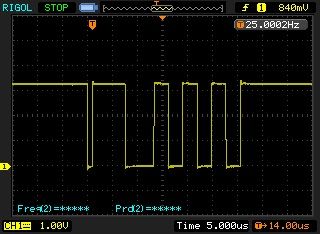

2014-07-31 12:39 AM
Thanks, fail start delay twisting less and the byte looks good by the oscilloscope.
The problem of receiving bytes on the receiver side was solved by changing HSE_VALUE variable in the ''stm32l1xx.h'' file, simply a real baudrate was wrong. By default it was 8MHz, now it fixed. I have initialized DMA on TX direction from memory to peripherial, and it works, but looks wrong - from array of 10 elements only 8 can be transferred. The last two bytes just lost. I can to create an array with size+2 and all good, but can it work normally? (I have to transfer 185 bytes, so to use interrupt routine is not a good way. )#include ''stm32l1xx.h''
