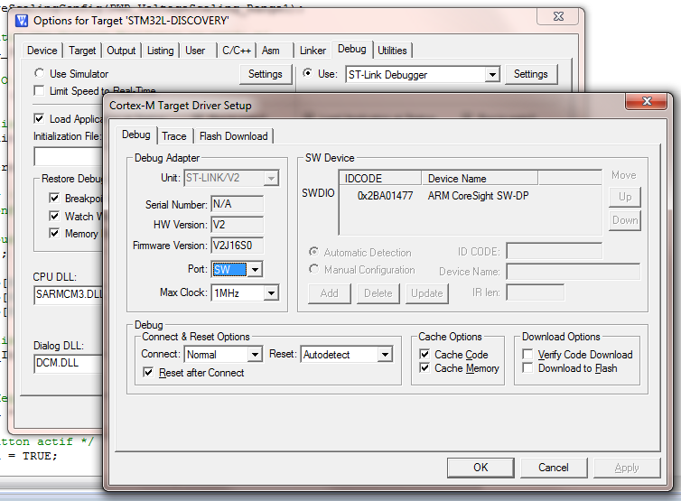

Hello Clive,
thank you for your answer. Aftersuccessfully flashing the new firmware I have the Version V2.JS0 (which seems to be not the newest one). But, when I want to Set the Debugger, it shows: No Cortex-M SW Device found (/public/STe2ecommunities/mcu/Lists/STM32Discovery/Attachments/7439/Keil_STM32L_Problem.JPG
) . I plugged the device in and out, restarted the Keil application, without any changes. The Keil project is a blinky-project which was preinstalled. For a first test, I wanted to flash this programm. I have another Microcontroller from ST, the STM32F303 and this controller works fine. Like you see in File ''/public/STe2ecommunities/mcu/Lists/STM32Discovery/Attachments/7439/Bildschirm_2.JPG
'', the debugger is found by Windows. The driver seems to be OK, too (/public/STe2ecommunities/mcu/Lists/STM32Discovery/Attachments/7439/TreiberVersion.JPG
). But I have no clue, why it isn't found by Keil or other programming software. Maybe, there is no connection between the debugger and the ARM-chip. Edit: I also tried the instruction given by this link: http://www.keil.com/forum/21913/ ________________ Attachments : Bildschirm_2.JPG : https://st--c.eu10.content.force.com/sfc/dist/version/download/?oid=00Db0000000YtG6&ids=0680X000006HzY5&d=%2Fa%2F0X0000000bOY%2FvXdtdxhYGG91L15.qSw8eR4sRU8lhkiFscFf0elp3N4&asPdf=falseKeil_STM32L_Problem.JPG : https://st--c.eu10.content.force.com/sfc/dist/version/download/?oid=00Db0000000YtG6&ids=0680X000006HzcV&d=%2Fa%2F0X0000000bOU%2FXwyQjj_Sj0N0yFpOLRlXVZGhEu79ReRUOH1LkvMxv4A&asPdf=falseTreiberVersion.JPG : https://st--c.eu10.content.force.com/sfc/dist/version/download/?oid=00Db0000000YtG6&ids=0680X000006HzH9&d=%2Fa%2F0X0000000bOV%2FazgYkE0U6vd3PeVTL8axGFRZ_vWFDHO08B6ZSI8dsXQ&asPdf=false2013-09-06 2:11 AM
