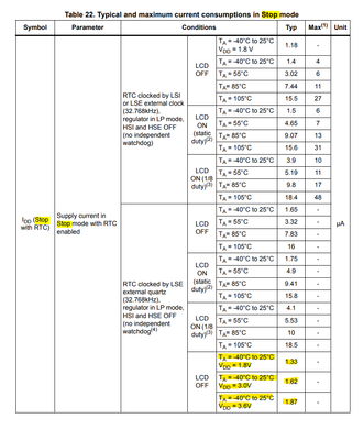

As you can observe from the datasheet for stop mode:
Under the same temperature conditions, with RTC enabled:
At VDD=1.8 V, the typical current consumption is 1.33 µA.
At VDD=3 V, the typical current consumption is 1.62 µA.
At VDD=3.6 V, the typical current consumption is 1.87 µA.
So, there might be an issue with your configuration
