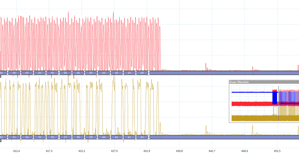

After the transmission of the initial package with the numbered bytes array (Configuration_Values_Tx[64] = {1, 2, ..., 64 }) was sent the following 64Byte packages had a value of "64" for each byte (like the "64_Problem_Package_2_01" screenshot).

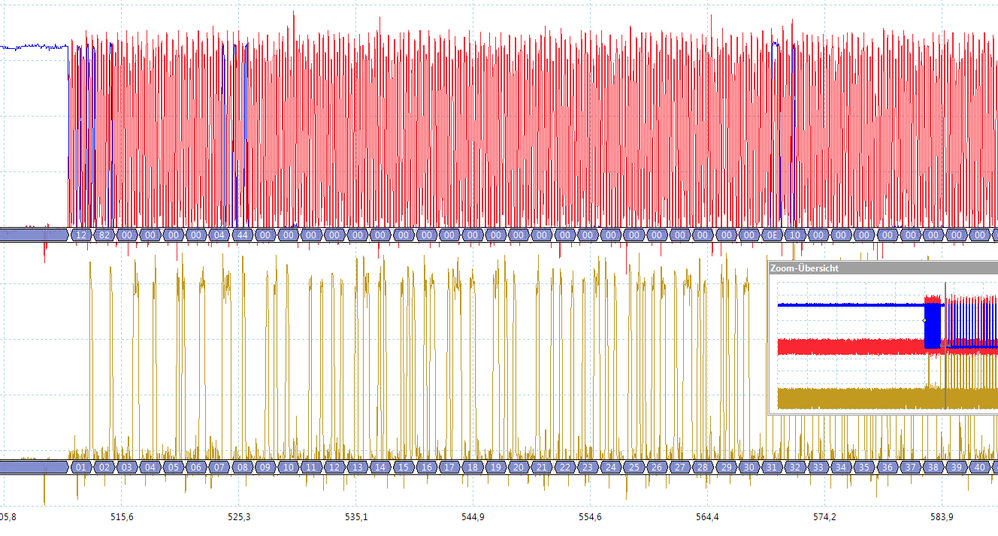

  1. The 1st Package is my initial dummy 64 Byte Array
  2. The 2nd Package should be the received data from the 1st transmission, but the 1st byte of the seconde package is always 01.
  3. The 3rd Package and the following Packages are correct.
The 01 could be from the 1st package where the dummy values are sent, but why? The 3rd and following packages don't show this behavior?
