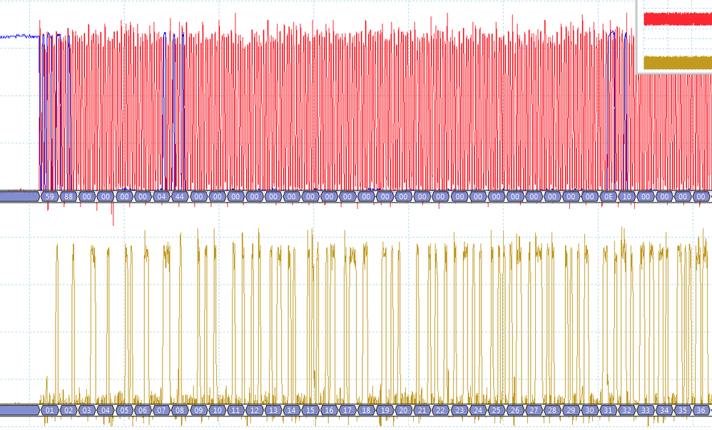

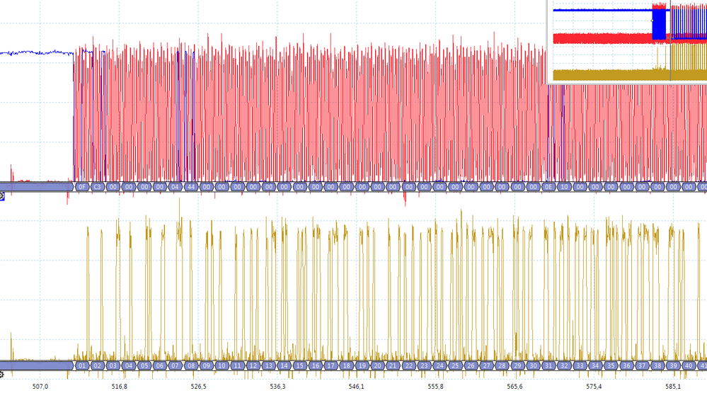

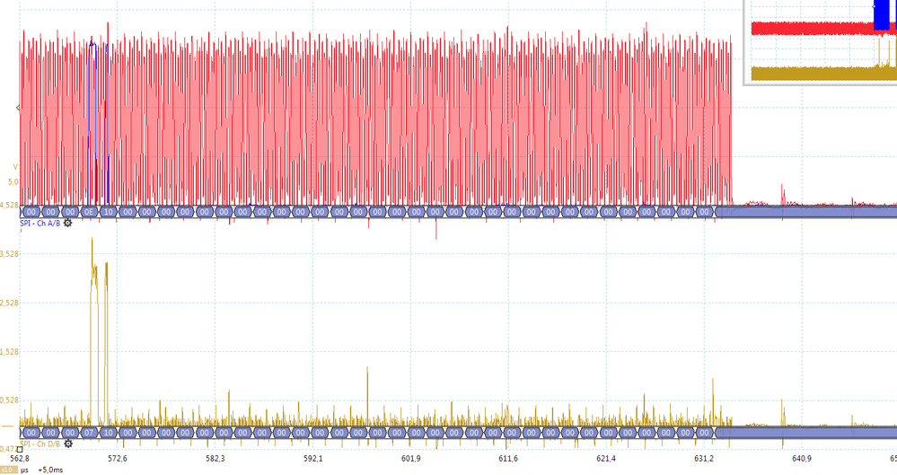

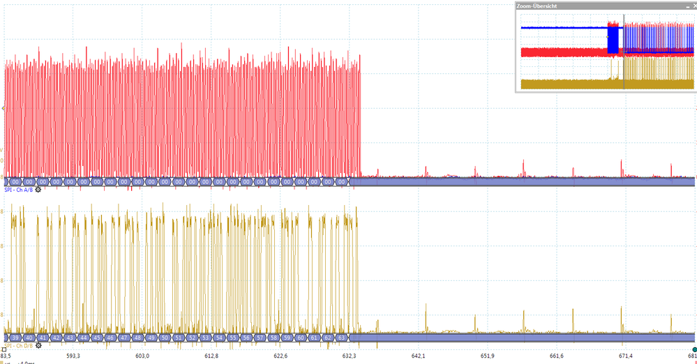

With the code below and two problems occured:

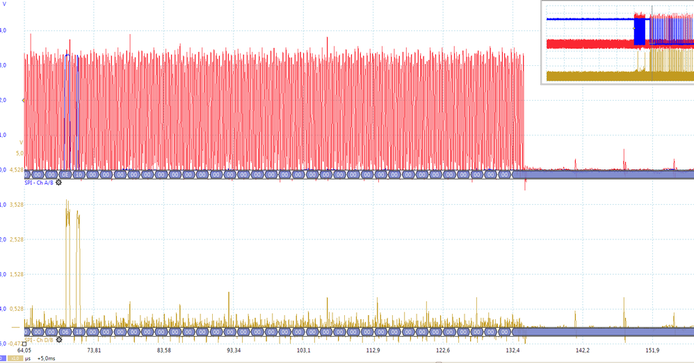

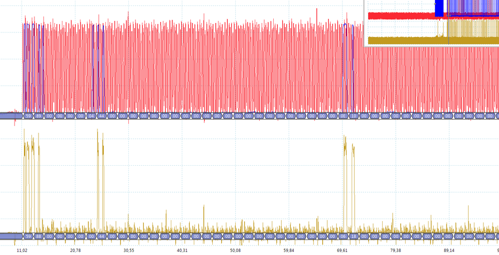

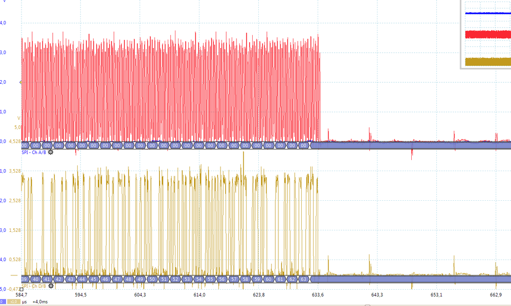

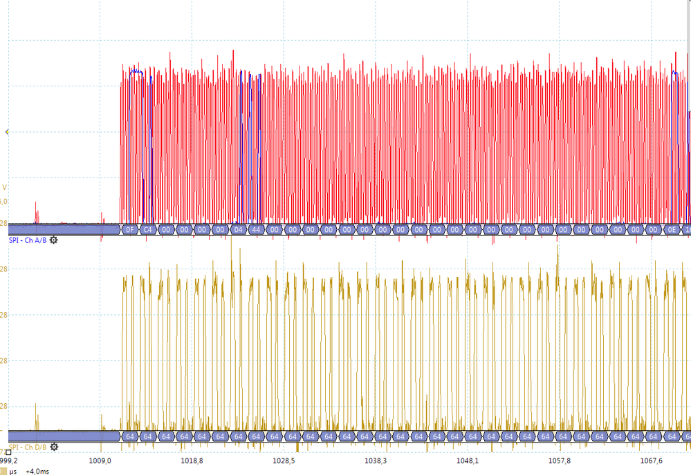

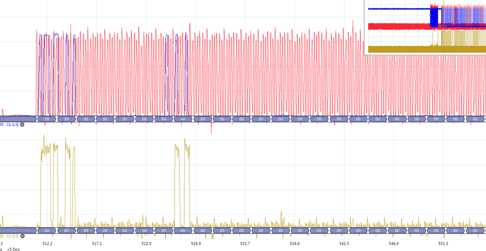

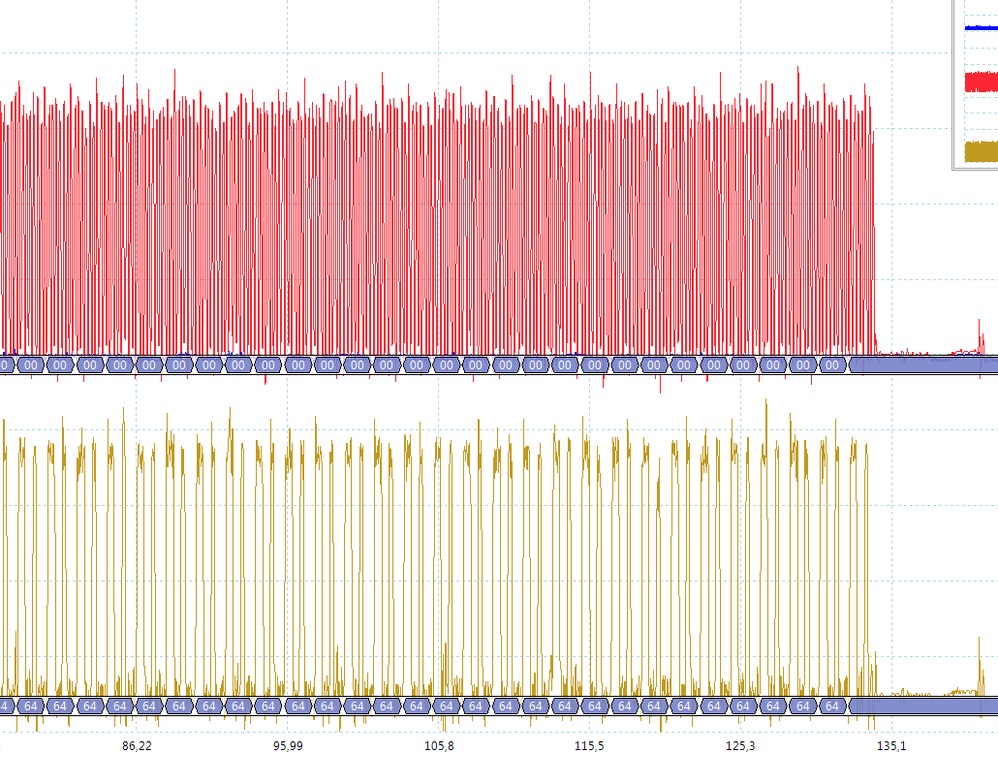

  • Data is not received properly / corrupted by my software (See attached Files Package_1 to Package_3)
  • After the 1st Package the transmission gets stuck at 64 (See attached Files 64_Problem)
Either one of the scenarios happen whenever I trigger the communication.
0693W00000GY2sbQAD.png0693W00000GY2rsQAD.png0693W00000GY2rJQAT.png0693W00000GY2rEQAT.png
0693W00000GY2lpQAD.png0693W00000GY2laQAD.png0693W00000GY2kOQAT.png0693W00000GY2kIQAT.png0693W00000GY2kDQAT.png0693W00000GY2jyQAD.png
while (1)
       HAL_SPI_TransmitReceive_DMA(&hspi1, Configuration_Values_Tx, Configuration_Values_Rsx, 64);
void HAL_SPI_TxRxCpltCallback(SPI_HandleTypeDef * hspi)
  for (iter_i =0; iter_i < sizeof(Configuration_Values_Rsx); iter_i ++)
    Configuration_Values_Tx[iter_i] = Configuration_Values_Rsx[iter_i];
