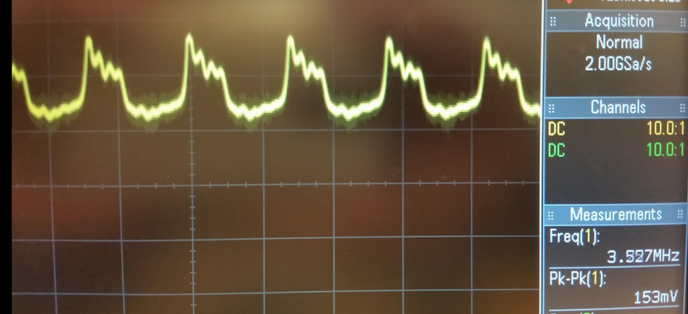

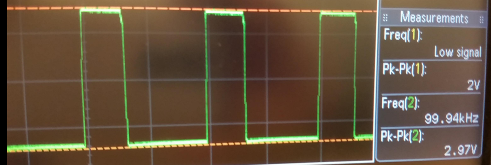

When I run my board with this code I find that the TIM4 correctly ouputs a 100KHz square wave with a peak to peak voltage of 3V. The TIM11 channel outputs an unclean square wave with a very low peak to peak voltage and only approx. a 3.5MHz signal. If I try to reduce the prescaler value to 1 in order to increase the frequency further, I lose the waveform completely. The results from the oscilliscope are show below:
TIM4 -
TIM11 -
Any help on getting the TIM11 pwm to be a clean square at 5MHz with 3V peak to peak would be greatly appreciated.

Set higher speed setting on given pin in GPIO.
How do you load that pin?
Also, check your oscilloscope probe rating.
If you need pwm if that kind of frequency, there is something serious wrong with your approach, usually.
Probably yes, but the waveform should be clean nonetheless.

2018-03-06 2:36 PM

is correct,check the PIN IO Speed.
check the ground probe on your scope.
check the pin loading.
Upto about 16MHz should be possible, however, since the process is ' divide the fixed frequency primary clock', only some frequency choices are available. 32Mhz/2, 32/3. 32/4 etc.

I used the CubeMX software to generate this script file. It allowed me to just select the timer that I wanted to use and I then specified the channel I desired and that allocated the pin on for me on the GUI. I then output the script file from this software.
I went back into the CubeMX software and saw that my pin for the timer output was set to a low speed so this may very well be the problem. I have now set it to a high speed and will test soon.

I am using also CubeMX , for my stm32f103 I don't see anything about pin speed set up, there is a limitation , @ 5.1MHz has 10% less amplitude. If you need exactly 5MHz on your board you need to change crystal to 30MHz.

If you look in the configuration section of CubeMX, under the Control tab click on the timer that you have set up in the GUI and navigate to the GPIO Settings tab, there is a maximum output speed setting which can be set from Very Low all the way to High.
I don't need precisely 5MHz so I think I should be ok.
