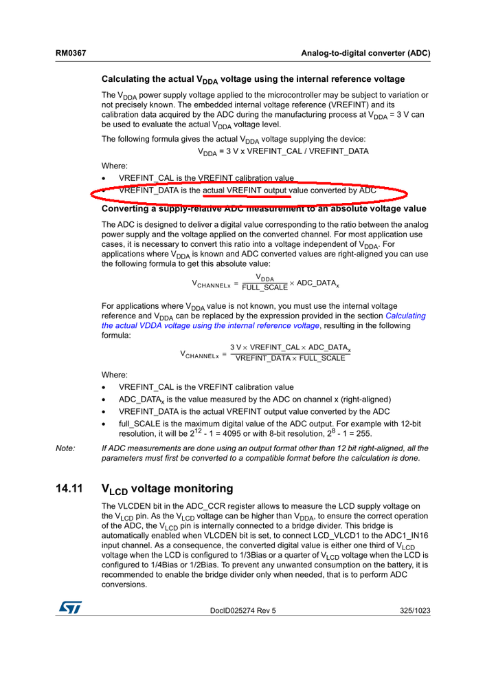

No, VREFINT_DATA is not the readout from the internal VREF source. It's the A/D conversion of the external Vdda pin on the processor. VREFINT_CAL is the factory stored ADC value of the internal precise voltage reference of 3V. It just makes no sense in multiplying 3V with the corresponding ADC value as is done in the reference manual.
My RM says otherwise:
But I understand your confusion. The RM should be clearer in stating, that that formula is to be used when VREF+ is tied to VDDA, and their voltage is not known (the intended usage of this is in direct-battery-powered appliances).
