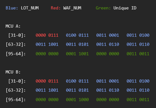

Here are my assumptions. We have 3 distinct fields:
Is the "Unique ID" field really unique? If yes, is it unique among all STM's MCU/MCPs, all STM32 MCUs, all STM32L0 Series, STM32L0x0 Value Line, …
Below is the full UID registers of two distinct STM32L010C6T6 I own.

In your example, the IDs only differ in bit 80.
