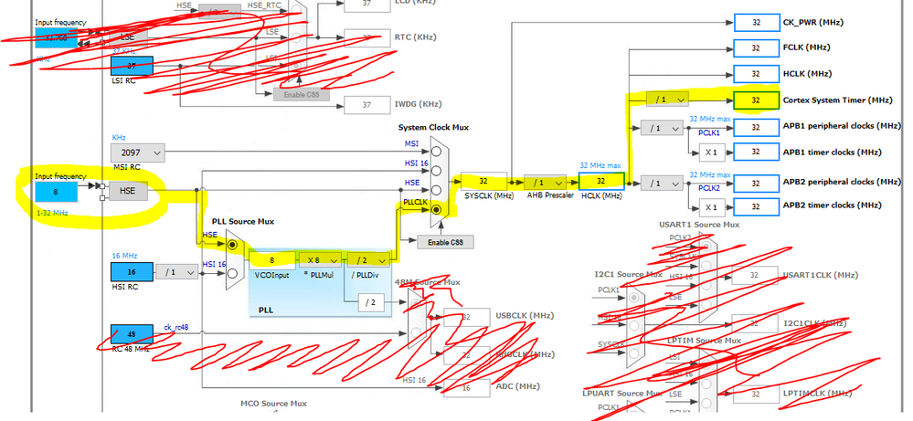

Here is my PLL configuration (please read the comment maybe I missed something obvious):
RCC->CR |= (1 << 16); //HSE on 8mhz
RCC->CFGR |= (1 << 22); //PLL out div by 2 RCC->CFGR |= (1 << 0) | (1 << 1); //Select Sysclck as PLL RCC->CFGR &= (~(1 << 7)); //clear bit 7 for AHB prescaler = 1 RCC->CFGR &= (~(1 << 10)); //clear bit 10 for APB1 prescaler = 1 RCC->CFGR &= (~(1 << 13)); //clear bit 13 for APB2 prescaler = 1 RCC->CFGR |= (1 << 16); //PLL source is HSE RCC->CFGR |= (1 << 18) | (1 << 19); //PLL multuplier = 8 (i.e 8mhz hse * 8 = 64 div by 2 = 32 Sysclck maximum) RCC->CR |= (1 << 24); //PLL on while((RCC->CR & (1 << 25)) == 0); //wait for PLL ready SystemCoreClockUpdate(); //SystemCoreClock variable is 32Mhz (confirmed by debugger)And then here is my Systick configuration: SysTick->CTRL = 0; SysTick->LOAD = 31999; //Systick clock/1000 - 1 for 1ms systicks interrupt NVIC_SetPriority(SysTick_IRQn, (1<<__NVIC_PRIO_BITS) -1); SysTick->VAL = 0; SysTick->CTRL |= SysTick_CTRL_CLKSOURCE_Msk; //choose full AHB as source clock (no div by 8) SysTick->CTRL |= SysTick_CTRL_TICKINT_Msk; //enable interrupt SysTick->CTRL |= SysTick_CTRL_ENABLE_Msk; //Enable systickI am getting a 2ms interrupt instead of 1ms. I checked the PLL clock divider in RCC-CFGR and it was indeed 0 (i.e. no division). There has to be a division by 2 somewhere that I am missing. My reference is the STM32CubeMX Clock Configuration and of course the datasheet.
I don't really know where else the problem could be. Any help would be appreciated!

32MHz.I am only using STM32CubeMX as reference for the 'clock tree'. (everything is barebones, no generated code used).
