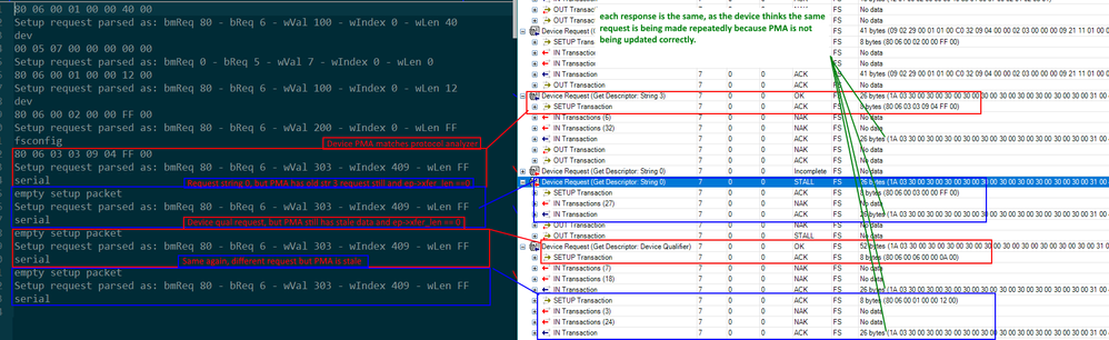

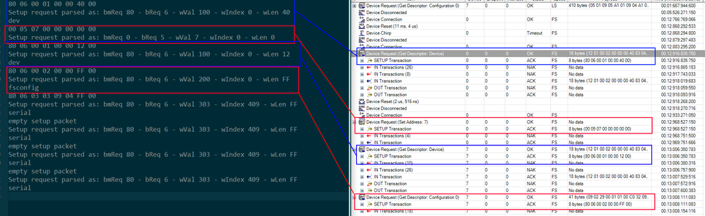

So I'm currently working on a custom HID with STM32L073CZ using code generated by the latest version of Cube and CubeMX, and I'm running into an issue with intermittent enumeration being caused by SETUP packets not always being recognised properly. Enumeration begins without issues (you can see here the on-device log, showing the PMA contents, on the left matching up with my protocol analyzer output on the right):
However, at some point during the enumeration process (not always on the same request), the device receives a SETUP packet, that it wrongly interprets as being of length 0 (xfer_count is 0 after the following line executes):
ep->xfer_count = PCD_GET_EP_RX_CNT(hpcd->Instance, ep->num);
This means that when PCD_ReadPMA is called with wNBytes == 0, that nothing is copied from the PMA into hpcd->Setup. All fine and dandy, but hpcd->Setup still contains the SETUP information from the previous packet.
This is a problem, because HAL_PCD_SetupStageCallback is called regardless, meaning that the previous SETUP packet is handled again with the stale hpcd->Setup contents, leading to the following problem:
The protocol analyzer clearly shows SETUP packets with their contents changing, but the device believes the setup packet to be empty, and further logging of the PMA contents directly inside ReadPMA shows that the PMA contents don't change either.
