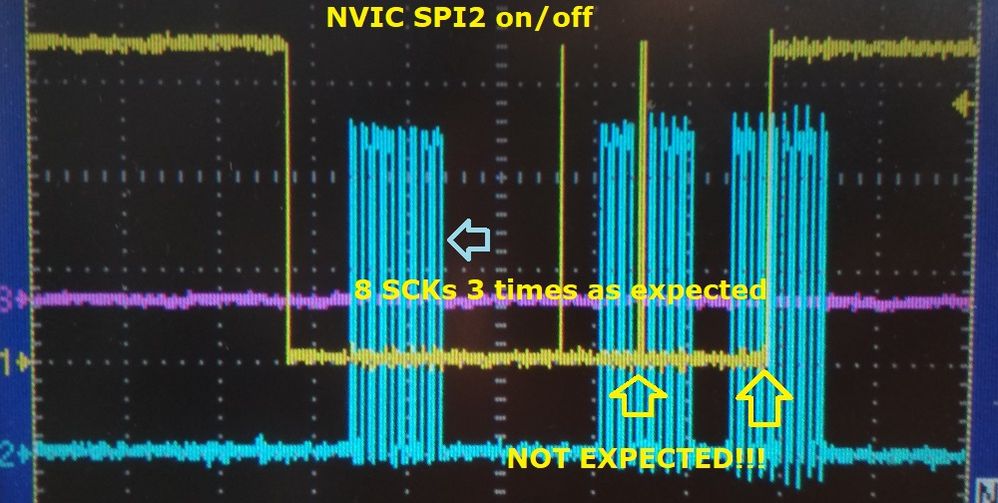

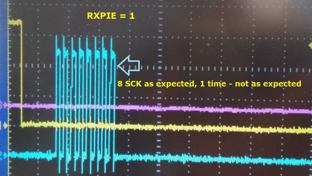

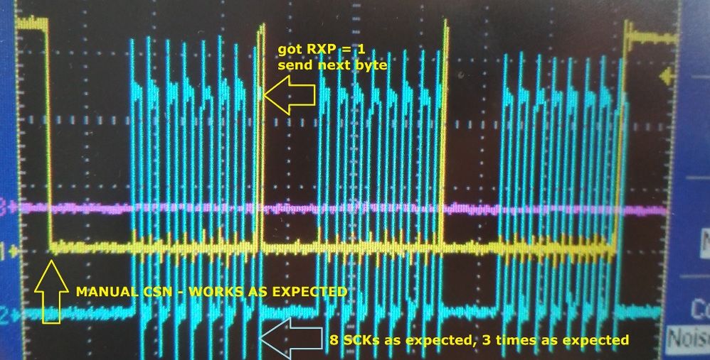

Here are those oscilograms
I make manual CSN, send 3 bytes
Next is Changing interrupt control bit in ISR (IER = 0), 1 was byte sent, system stall repeating SPI interrupt routine multiple times! Totally unexpected.0693W000003RRwnQAG.jpg
FInal is where I disable NVIC SPI2 interrupt in ISR. First byte is read after full transmission, next interrupts fire in the middle of transmission! How can it be?0693W000003RRyOQAW.jpg
