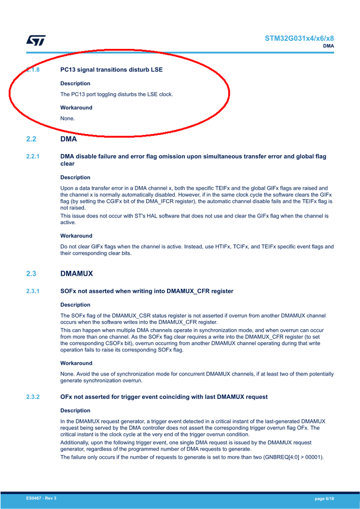

You mean, like it is in the STM32G0 series?
PS.
@Imen DAHMEN​ , maybe this deserves some attention...?
That's right.
I think that the same phenomenon as the STM32G0 and STM32L4�?STM32WB series is occurring.
