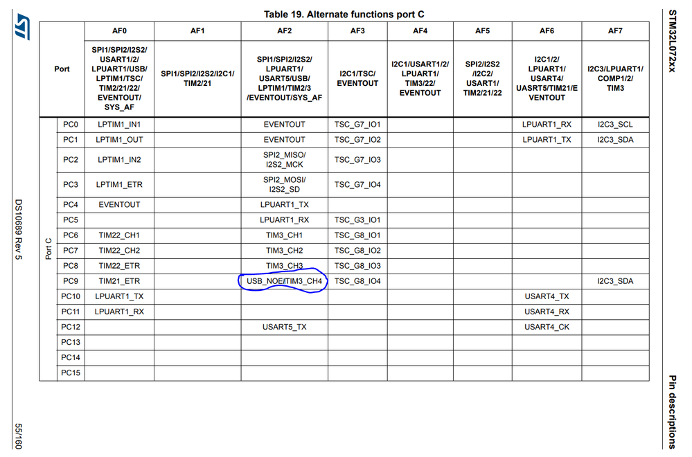

I am trying to Define PC9 as AF2 for analog output.
After defining, the output keeps high. How can I define it as "TIM3_CH4" not" USB_NOE"?
It could be the reason getting HIGH.
Thanks!
Jason

Hi @Imen DAHMEN ,
this is IMO a surprising feature - two peripherals controlling a single pin - and maybe even more surprising is that it is multiplexed in TIM module.
I would suggest a footnote to both the Pin definitions and Alternate functions tables, in all related datasheets.

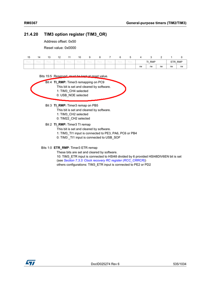

[EDIT] It also appears, that PC9 has this "dual" function only in 'L07x, so this IMO deserves also a mention, this time in the TIM3_OR bit 4 description, in the two relevant Reference Manuals.
Can you please look at this. Thanks.
2023-03-02 9:38 AM
This is correct path. It is fixed.
Thanks!
