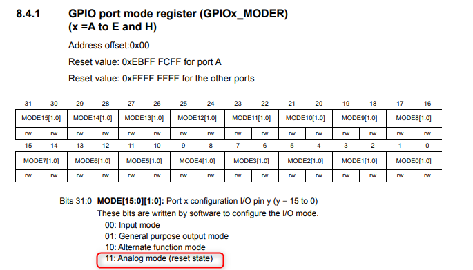

2021-09-22 6:35 AM
2021-09-22 6:35 AM
does it mean it is in analog mode by default ?
2021-09-22 6:41 AM
Yes, corrected.
As stated in your other thread, if the GPIOx register settings are the same in both configurations, that's not the source of your problem. Registers tell the full story. Has to be a difference somewhere else.
