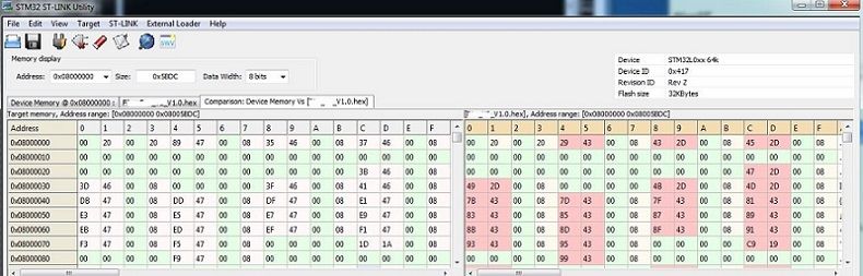

Here is the capture of the byte comparison(Sorry for the resolution, i cannot upload a picture bigger than 100 KB). The first difference is found at the address 0x0800 0004. Instead of 0x29 , I have 0x89.

I tried -e number_of_pages pageN°. It is better. When the memory is erased, the data written is corrected. But I need to erase more than 180 pages, so the command will a litte long, because i need to indicate each pageN°. Is there a solution for it?
