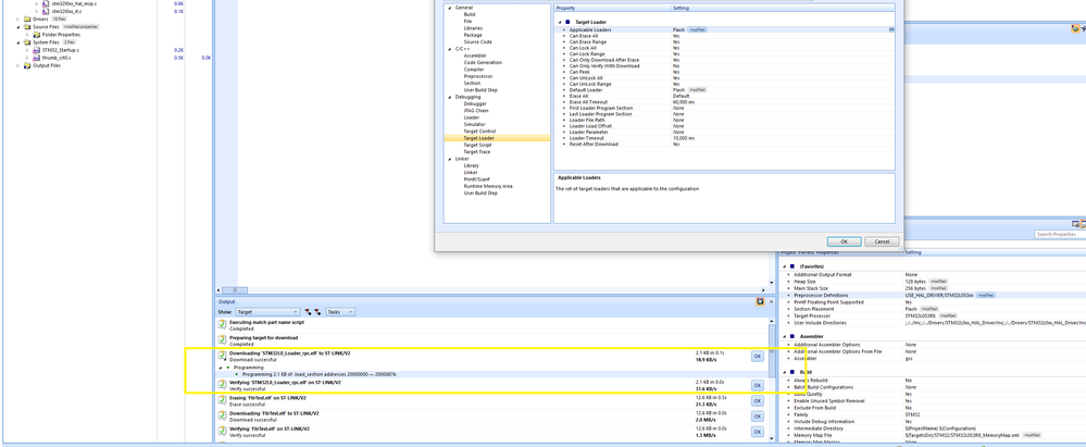

Hi, i manage to load it to the flash i think, however the reset button wont work when i use build and run. even I have set the STARTUP_FROM_RESET.
below is the download log:
xecuting match part name script
Loading target script file STM32_Target.js
Executing script MatchPartName("STM32L053R8")
Preparing target for download
Executing script FLASHReset()
Downloading ‘STM32L0_Loader_rpc.elf’ to ST-LINK/V2
Programming
Programming 2.1 KB of .load_section addresses 20000000 — 2000087b
Programming completed in 64 ms — 33,937 bytes/sec
Download successful
Verifying ‘STM32L0_Loader_rpc.elf’ on ST-LINK/V2
Verifying
Verifying 2.1 KB of .load_section addresses 20000000 — 2000087b
Verifying completed in 45 ms — 48,266 bytes/sec
Verify successful
Erasing ‘FlirTest.elf’ on ST-LINK/V2
Erasing
Erasing 12.6 KB of addresses 08000000 — 080032bc
Erasing 0.0 KB of addresses 080032c0 — 080032c3
Erasing completed in 592 ms — 21,947 bytes/sec
Erase successful
Downloading ‘FlirTest.elf’ to ST-LINK/V2
Programming
Programming 12.6 KB of addresses 08000000 — 080032bc
Programming 0.0 KB of addresses 080032c0 — 080032c3
Programming completed in 7 ms — 1,856,142 bytes/sec
Download successful
Verifying ‘FlirTest.elf’ on ST-LINK/V2
Verifying
Verifying 12.6 KB of addresses 08000000 — 080032bc
Verifying 0.0 KB of addresses 080032c0 — 080032c3
Verifying completed in 9 ms — 1,443,666 bytes/sec
Verify successful
Preparing target for user application
