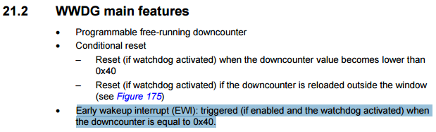

Hello Andy,
1)
STM32L0 MCUs embeds two watchodg units: Independent Watchdog (IWDG) and System Window Watchdog (WWDG). Second one, so WWDG, has a capability to generate an interrupt. This interrupt can wake up the MCU from STOP mode.
2)
In STOP mode states of GPIOs outputs remains unchanged. If STM32L0 configured outputs to low states before entering STOP mode, they will remain low in STOP mode. The same with GPIOs set to high state.
Let me also mention, that configuratio of GPIOs remains unchanged. So for example if you configure pull-down or pull-up on the GPIO input, it will be also active in STOP mode.
