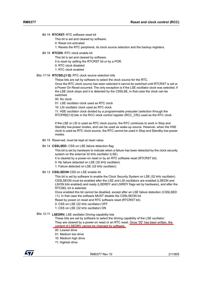

I've just tried on an 'L031 - after writing LSEDRV to 0b00 (using debugger), I can rewrite it freely to any other value, and the oscillator's behaviour follows the value written.
Can ST please comment.
