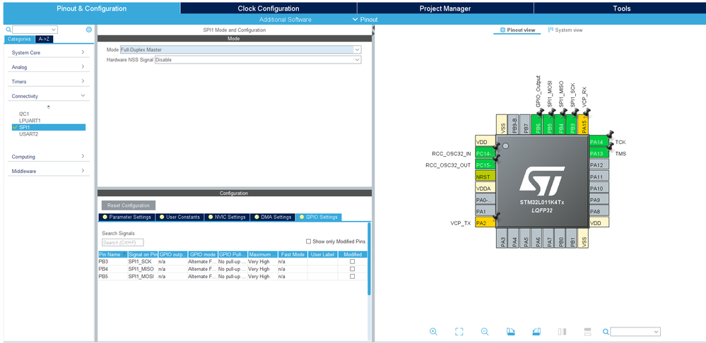

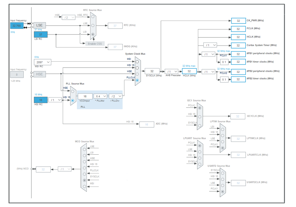

I have tried a lot of stuff but i cant get the SPI working properly. I included my main.c file which most were automatically created in CubeMX (see pictures of configuration).

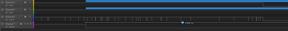

Programming and Flashing is done in CubeIDE. For testing i used my Logic Analyzer, and get the screen you see in the picture. "CLK state missmatch idle state". But CPOL and CHPA are both set to 0, in the CLK Register and in the Logic Analyzer.

thanks for your reply! I changed the code and in my Logic Analyzer there is no missmatch anymore! But the CLK-Line doesnt look good and on the MOSI Line seemed to be random 8-Bit words. During CS Low there are 8x8 Bits transfered through MOSI in the following order:
0x08 0x00 0x00 0x00 0x00 0x5D 0x1B 0x00
But in my code i just want to send 0x9F and than end the transmission. In CubeMX i could not found any setting for Idle state.

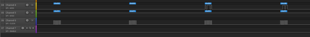

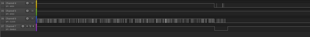

2020-04-22 7:43 AM
Second picture is the whole transmission zoomed out. As you can see there is noise on the CLK Line. The first picture is zoomed in into CS LOW transmission. Do you have any ideas?
