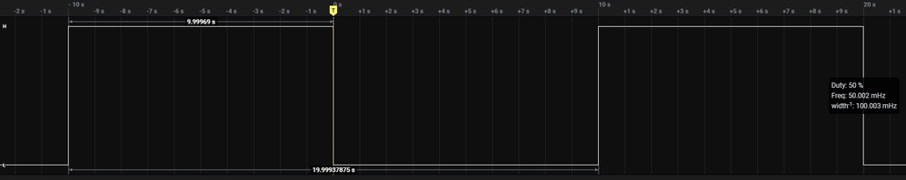

find attached my code for STM32L010x.
It utilizes an RTC wake-up timer to wake-up the CPU from the SLEEP mode every 10 sec.
RTC is clocked by the LSE (accurate external low-speed oscillator).
I set asynchronous RTC divider to 127 and synchronous RTC divider to 255 to get 1 Hz (take a look into the reference manual RM0451, this clock on the output of the synchronous prescaler is marked as ck_spre)
The ck_spre clock is then used to feed the RTC wake-up timer (so 1 clock cycle takes 1 second).
The RTC wake-up timer is set to 0x0009 to fire an interrupt every 10 seconds.
You may want to change the RTC clock source from LSE to LSI, if there is no 32.768k quartz for LSE available on your board.
The wake-up period would then be far less accurate.
Before entering the SLEEP mode you need to disable the SysTick timer, otherwise its interrupt would wake-up the CPU within 1 ms (the SysTick is typically set to raise an interrupt every 1 ms).
HAL code generated by STM32CubeMX configures the SysTick at the beginning of the main function.
To disable the SysTick you can call:
HAL_SuspendTick();
After wake-up I toggle with PA5 before entering the SLEEP again to verify the proper wake-up period with my Saleae digital analyzer (see the picture below).
This part can be easily removed by removing the associated GPIO code.

/* USER CODE END 3 */
* @retval None
void SystemClock_Config(void)
RCC_PeriphCLKInitTypeDef PeriphClkInit = {0};
__HAL_PWR_VOLTAGESCALING_CONFIG(PWR_REGULATOR_VOLTAGE_SCALE1);
/** Configure LSE Drive Capability
HAL_PWR_EnableBkUpAccess();
__HAL_RCC_LSEDRIVE_CONFIG(RCC_LSEDRIVE_LOW);
RCC_OscInitStruct.OscillatorType = RCC_OSCILLATORTYPE_HSI|RCC_OSCILLATORTYPE_LSE;
RCC_OscInitStruct.LSEState = RCC_LSE_ON;
RCC_OscInitStruct.HSIState = RCC_HSI_ON;
Error_Handler();
RCC_ClkInitStruct.SYSCLKSource = RCC_SYSCLKSOURCE_HSI;
RCC_ClkInitStruct.APB2CLKDivider = RCC_HCLK_DIV1;
if (HAL_RCC_ClockConfig(&RCC_ClkInitStruct, FLASH_LATENCY_0) != HAL_OK)
Error_Handler();
PeriphClkInit.PeriphClockSelection = RCC_PERIPHCLK_RTC;
PeriphClkInit.RTCClockSelection = RCC_RTCCLKSOURCE_LSE;
Error_Handler();
* @brief RTC Initialization Function
* @param None
* @retval None
static void MX_RTC_Init(void)
/* USER CODE BEGIN RTC_Init 0 */
/* USER CODE END RTC_Init 0 */
/* USER CODE BEGIN RTC_Init 1 */
/* USER CODE END RTC_Init 1 */
/** Initialize RTC Only
hrtc.Instance = RTC;
hrtc.Init.HourFormat = RTC_HOURFORMAT_24;
hrtc.Init.AsynchPrediv = 127;
hrtc.Init.SynchPrediv = 255;
hrtc.Init.OutPut = RTC_OUTPUT_DISABLE;
hrtc.Init.OutPutRemap = RTC_OUTPUT_REMAP_NONE;
hrtc.Init.OutPutPolarity = RTC_OUTPUT_POLARITY_HIGH;
hrtc.Init.OutPutType = RTC_OUTPUT_TYPE_OPENDRAIN;
if (HAL_RTC_Init(&hrtc) != HAL_OK)
Error_Handler();
/* USER CODE BEGIN RTC_Init 2 */
/* USER CODE END RTC_Init 2 */
* @param None
* @retval None
/* GPIO Ports Clock Enable */
__HAL_RCC_GPIOC_CLK_ENABLE();
__HAL_RCC_GPIOA_CLK_ENABLE();
/*Configure GPIO pin Output Level */
HAL_GPIO_WritePin(GPIOA, GPIO_PIN_5, GPIO_PIN_RESET);
/*Configure GPIO pin : PA5 */
GPIO_InitStruct.Pin = GPIO_PIN_5;
/* USER CODE BEGIN 4 */
void HAL_RTCEx_WakeUpTimerEventCallback(RTC_HandleTypeDef *hrtc)
// Callback called from the RTC interrupt service routine
/* USER CODE END 4 */
* @retval None
void Error_Handler(void)
__disable_irq();
while (1)
#ifdef USE_FULL_ASSERT
* @param file: pointer to the source file name
* @param line: assert_param error line source number
* @retval None
/* USER CODE BEGIN 6 */
ex: printf("Wrong parameters value: file %s on line %d\r\n", file, line) */
/* USER CODE END 6 */
#endif /* USE_FULL_ASSERT */

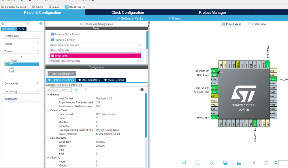

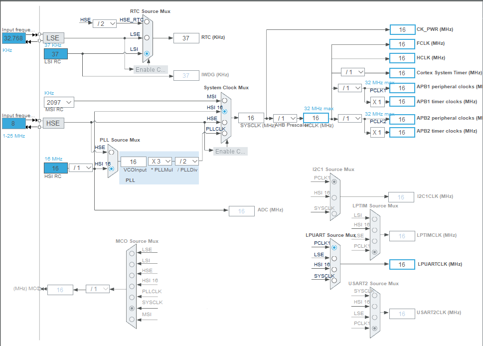

2024-07-01 3:13 AM
Hello sir,
I have tried to implement the same code as yours.But My MCU is not waking up from SLEEP mode.Can you pls help me with where i went wrong?.PFA my code for the same.
