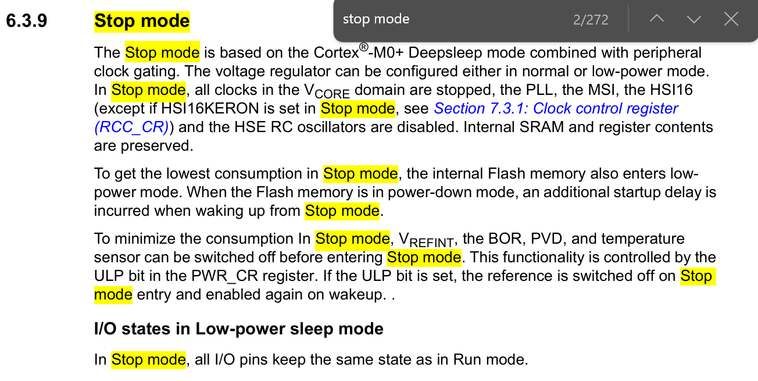

Try reference manual Ultra-low-power STM32L0x1 advanced Arm®-based 32-bit MCUs - Reference manual
all important info

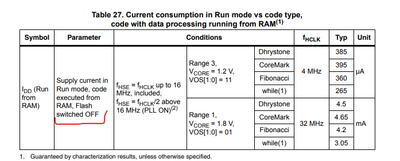

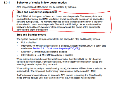

Also look what I've found :
It says about Flash memory and RAM being stopped. So if RAM is turned off then all the data in RAM is cleared in SLEEP mode ?
How it works when it wakes up ? It should start from where it Sleep mode was turned on, but RAM is cleared, there is no variables initialized there are no stack which says where we ended in the code, if there was a callback how it works when RAM is cleared ?

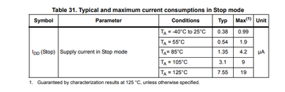

The STOP mode only contains this data without LP
While Sleep mode has a table when RAM is off
Can the code work not knowing when it ended ? So it must start from the beginning without the restart like in STANDBY.
I am confused how no RAM works in practice. When variables are cleared, stack is cleared (stack has the what part of the code is now executing or where it ended). it is all in RAM.
There is also an option to turn off only FLASH and this either I don't know what will result if I turn it off and then I wake up from SLEEP mode. What happens then.

Forget for RAM is cleared in any mode except STANDBY and SHUTDOWN .
Your red text is two sentence 1. code run from RAM 2. FLASH is off
For example you have batery app and require run som code at low power, then you place code in RAM and switch FLASH off. In this state your code can switch between RUN SLEEP usw.
After wake RAM is ok and have variables and stack...
You seems missunderstand RTC with 8k retention, but this is sentence when MCU is only on Vbat and STOP ...
