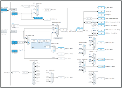

My clock configuration in STM32CubeMX:

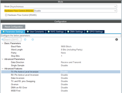

My LPUART configuration :

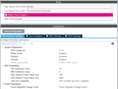

My RCC configuration:

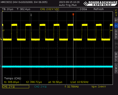

1. check LSE frequ. -> activate MCO and set to LSE ; check mco output ...

1) Frequency is correct, Picture below get from MCO output
