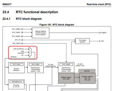

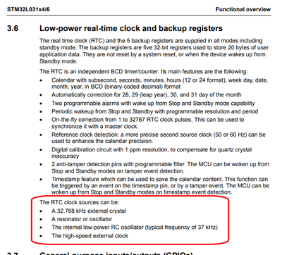

@JJoao.1 wrote:Should I use RTC as Clock source?
The RTC is not a clock source - it requires a clock source.
This is described in the Datasheet & Reference Manual:
