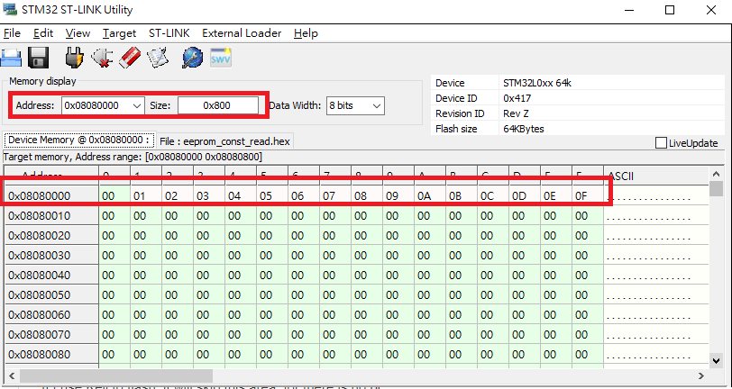

In my STM32L053 device, I also got 2K eeprom @0808 0000 - 0808 07FF.
If I create a const array with absolute address, such as:
const uint8_t eepromArray[16] __attribute__((at(0x08080000)))
= {0x00,0x01,0x02,0x03,0x04,0x05,0x06,0x07,0x08,0x09,0x0A,0x0B,0x0C,0x0D,0x0E,0x0F};
If I use Keil to flash, it will skip this area, for there is no programming algorithm at this section.
(for the moment, i don't know how to add or modify programming algorithm for keil).
But if I use the output hex file and ST-Link to program,
the eeprom is indeed programed.
Even though the ST-Link Utility only shows the the read out data in flash region, but it's indeed programmed.
In ST-Link, you may manually modify the memory display range like this
you can also confirmed this by using software code or by STMFlashLoader Demo.
I prefer use software codes to erase/write/read the eeprom data,
it seems that the above way for initializing the eeprom area does no harm too.
Hope this helps you.
Zt.

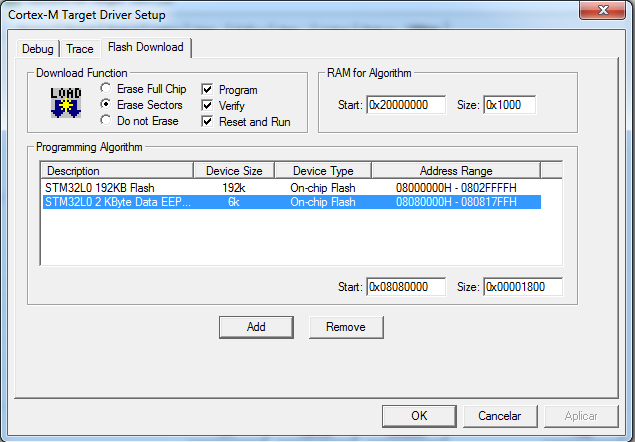

Also too programming the EEPROM from Keil IDE, in the options for targer->Debug->Settings->Flash Download
Add and select the EEPROM option.
2017-07-06 7:09 AM
Great! That's what I missed! Thx,
Cordoba_Papamija.Jho
