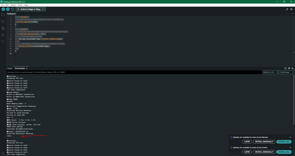

I'm developing a vibration and temperature sensor solution for industrial machinery.
Previously, my system was equipped with Atmega 328p chips, but it has now been upgraded to an STM32LO53C8T8 chip.
The circuit has a LoRa radio for sending signals to the gateway, a KX122-1037 accelerometer, a MCP9808 temperature sensor, a MAX17048 battery sensor and a MB85RC FRAM. I connected the TX pin to the arduino Mega to get a DEBUG display on the arduino IDE's serial monitor.
I assembled a PCB with the wiring diagram in the attached image, and it worked well for programming the microcontroller. However, I started to experience some problems when executing the code.

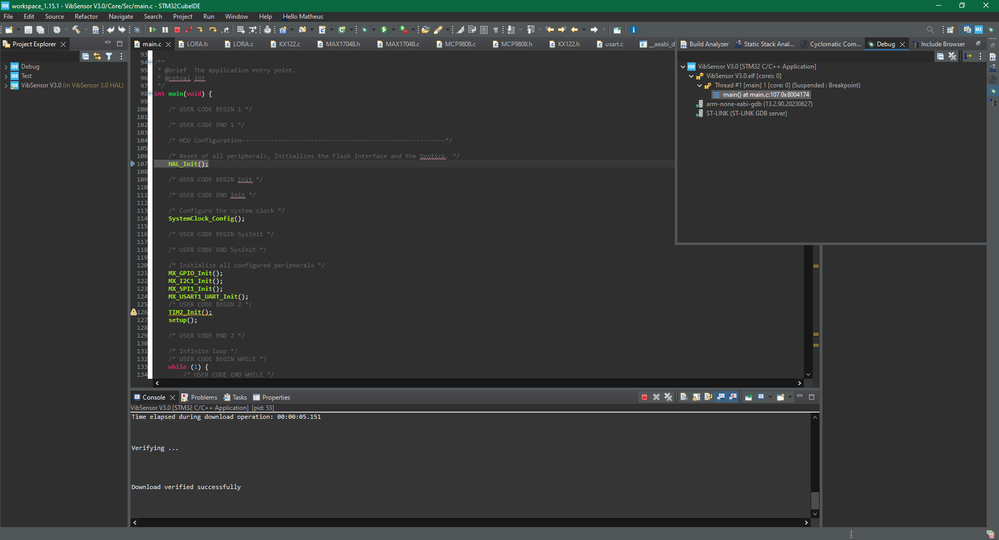

@MatheusMarkies wrote:In the STMCube debug mode, it is stuck on HAL_Init.
So step into that function to see where, exactly, it's getting stuck.

Why is your debug output corrupted at start of line? I saw this once when I was multiplexing a pin between SPI and UART modes, and was not respecting the timing for CS for the other chip when switching.
You should look into it - later.
2024-07-01 7:41 AM
Well, as I'm using the Mega which is powered by a 5V voltage, I believe it's corrupted by the difference in power supply voltages and the lack of a level shifter in the UART.

How can I debug it? This function is defined in a file called "stm32l0xx_hal.c".
The IDE debug is only showing what it executes in main.c

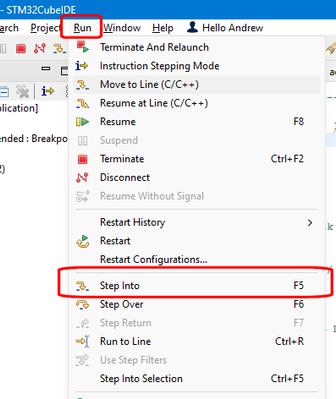

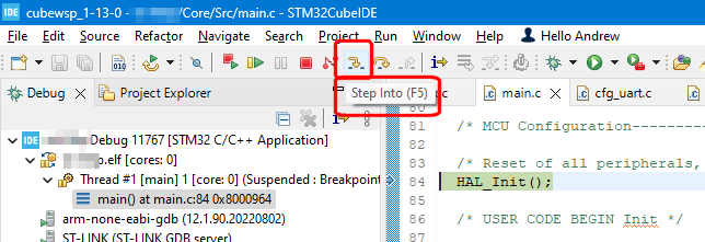

2024-07-01 8:00 AM - edited 2024-07-01 8:09 AM
Use the 'Step Into' button:
Also available on the 'Run' menu:
It's a pretty standard debugger feature - Microchip's MPLAB and Microchip Studio both have it:
https://developerhelp.microchip.com/xwiki/bin/view/software-tools/ides/x/debugging/debug-toolbar/
