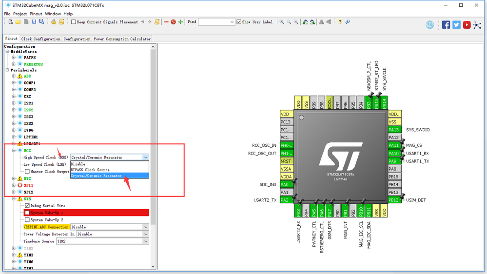

I'm using the same chip, and I have the same issue but I have get it work. You need to choose the HSE first in RCC like the pic below,and then you can change PLL using HSE. ADC's clock you can change with the code:

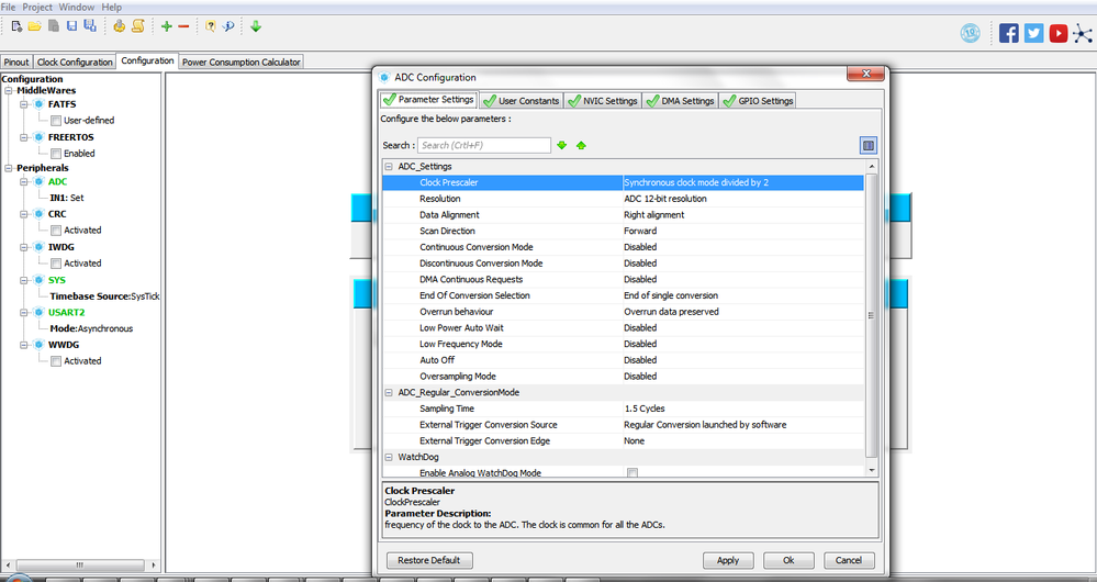

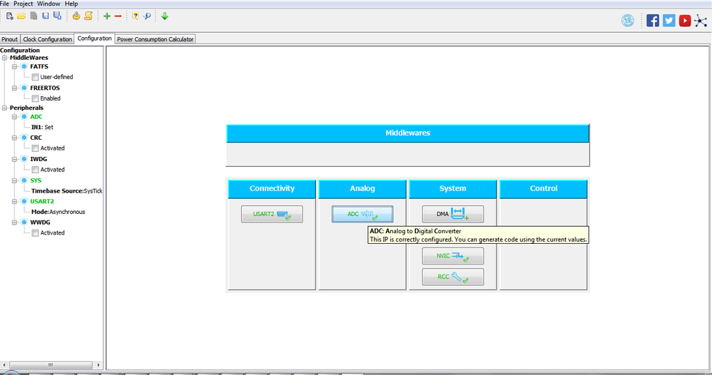

As shown below click on Configuration >> ADC
You will get adc configuration Options,
ADC Setting >> Clock Prescaler can be found.
