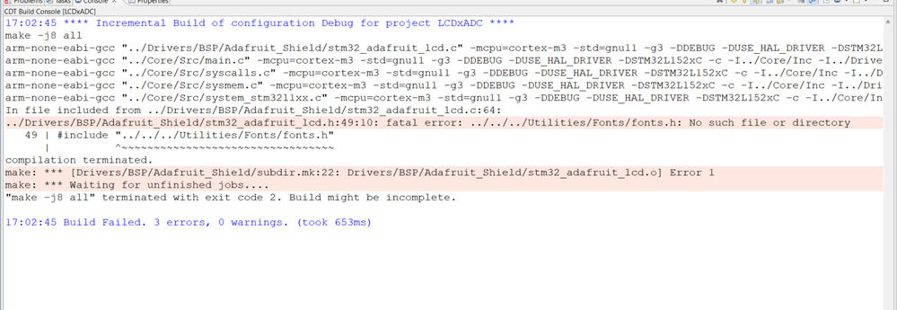

When trying to print characters on the onboard lcd screen of STM32L152RC dev board, getting this error. what to do?

Find the file in your CubeL1 repository and put it in your project tree structure so it can be found. Or fix the path.
