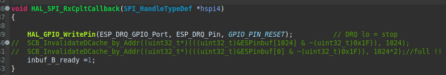

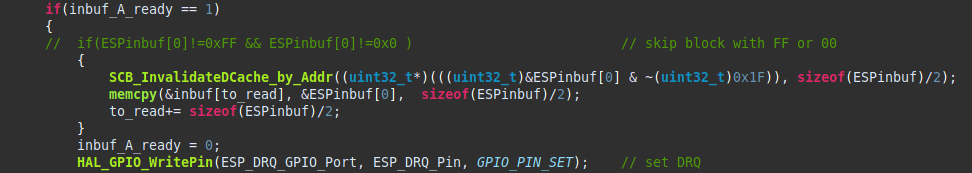

now it is running, always ...when data from spi comes, then copy from input buffer (in callback just set flag: buffer ready):
cache "clear" was not effective here, so i put it only just before using the buffer ->
then copy it, when needed (and clear flag :(

The cache maintenance is just flawed. You are doing the broken "adjustment" of invalidation function parameters, the second invalidation is missing and the buffer is probably not aligned properly. Just read my article, a link to which I posted below!
hm ? invalidateCache .. is wrong? maybe i can use the MPU - but i didnt find a simple and clear "how to do " . simple test with MPU on - crashed. (my fault, not mpu .)
? the other block, half /+ full , i do same. what missing else ?
i did. (not understanding all - but most, i think. )
so : what i could/should do better ? (actual state is working with no errors or dropouts - as far, as i seen until now )
