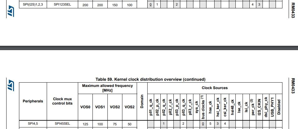

I can't seem to find it in the datasheet: what is the max allowed kernel clock frequency for SPI123 and SPI45?
1 ACCEPTED SOLUTION
3 REPLIES 3
Usually the Kernel Clock Distribution Overview in the RM not the DM/DS
On the H745/H747 to hand SPI123 200MHz SPI45 125 MHz
TwelveSquared
Senior
Thank you! I went crazy looking for that. Now I see it, in table 59 of the RM, rev 7. Thanks
