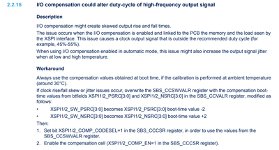

On top of the Article, which is cooking, we planned an official Product Errata-sheet as well for STM32H7RS and planned to be public on web in next couple of weeks, then to trig the Article.
Thank you for the patience.
Regards,
STOne-32.
STOne-32
Dear all,
We just released the New Errata sheet here : STM32H7Rxx/7Sxx device errata - Errata sheet
Next step is the Knowledge Article, thank you for the patience.
Regards,
STOne-32.

I would propose you to contact your local FAE or official ST office & support to discuss your application use case and understand the constraints.
The Main purpose of the Errata is to do this operation only on-time at manufacturing production of the boards and then save the values to be used during the whole application life, in general at Manufacturing assembly of the MCUs the temperature is controlled, and we stay in Ambient Values not exceeding 30°C or let's say from  10 to 30°C.
Hope it helps you
STOne-32.
@STOne-32  This helps for sure, indeed during manufacturing we do have control over the temperature. If calibrating just once to adjust to the board specific characteristics is sufficient this is a workable procedure. We will also test if this works over th efull temperature range of our product.

@Schwarzbach our product has proven stable in the range -5° - +60°C after applying the suggested workaround
